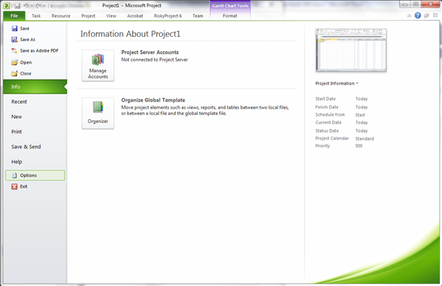

a). Launch MS Project. Then go to File -> Options:

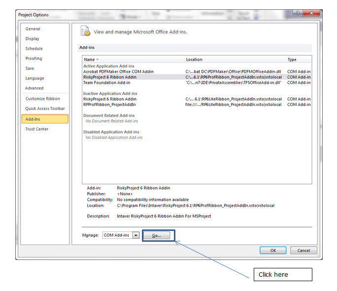

b). In Project Options, click Add-ins and then click Go:

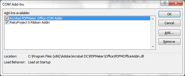

c). Make sure that RiskyProject ribbon add-in is visible and checked:
d). Click OK. Close and then relaunch Microsoft Project.

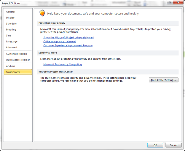

a). Launch MS Project. Then go to File -> Options -> Trust Center:

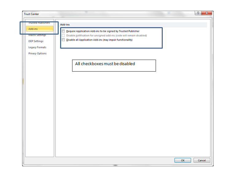

b). Select add-ins
c). All check boxes in this form must be cleared:
d). Click OK and relaunch Microsoft Project.
