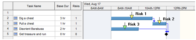

Two pirates, Jonny Death and Orlando Plume found that a treasure chest was buried beneath the parking lot of the Miami Dolphin’s Stadium and are planning to dig it out in the morning. However, Captain Barabusa suspects that Jonny and Orlando have discovered something and intends to arrive at the parking lot at exactly the same time. But our two clever pirates have a plan; while Jonny excavates the treasure chest, Orlando will attempt to disorient Barabusa by telling him that Jonny is just sewer repair contractor and send Barabusa off in the wrong direction. As part of their plan, they created a project schedule :

Here is how calculation works in our particular example. In each Monte Carlo simulation, changes in duration caused by particular risk are calculated. For example, in simulation 1 due to the risk “Concrete of the parking lot may be stronger than expected” Task 1 experiences a delay of 0.6 hours.
So the correlation coefficient is calculated between increases in duration caused by specific risks and project duration. Spearman Rank Order correlation coefficient between risk 3 and project duration equals zero. Why? Because the task “Disorient Barabusa” is not on the critical path. Even if the duration of the task will increase by 80% or 1.6 hours due to the risk and reach 3.6 hours, it will still be less than the duration of Jonny’s tasks: 3 hours +1 hours = 4 hours. It means that risk 3 does not affect project duration at all and the impact of this risk equals 0.
