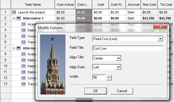

You can chance column name in the grid for each view, but not in dialog boxes. For example, you can change column name for Risk Register, Result Gantt, Cost and Income, Resources and other views, but you cannot change column name of task information, resource information, and risk information dialog boxes. Changing column name is very useful when you try to translate column name on another language.
To change column name right click on column header - the column will be highlighted. Then from drop down menu Select Modify Column. In the dialog overwrite column name with new column name.
New column name will be saved in the project file. Each time you open ALM file you will be presented with new column name.
