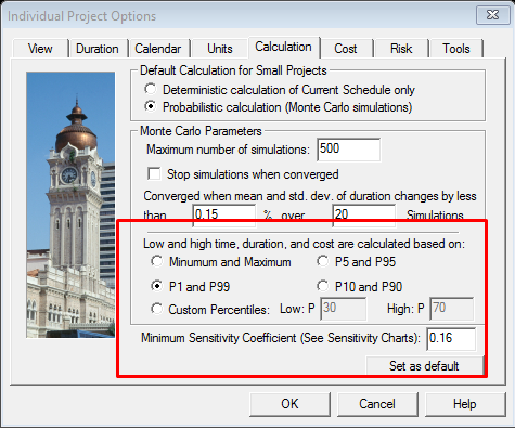

This is a 2-step process: first you have to change the percentiles used for high and low results. Second you need can view high and low results in the Resullt Gantt.
The Low and High results by default are set to P10 and P90. You can select either from several options or define custom percentile for low and high results. To modify to low and high results go to the Schedule tab>Settings and Options>Project Options> Calculations. In the Calculations tab, select the P1/P99 option.

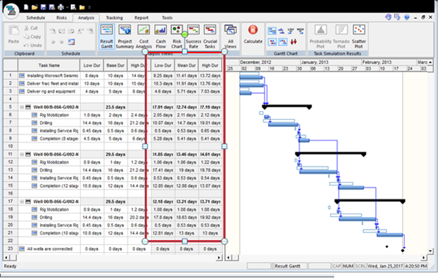

Now go to Analysis > Result Gantt view. The Low Dur and High Dur columns are now showing p1/p99 results for each task.
