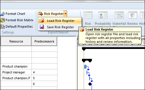

We have a generic set of risks that include probabilities and impacts that we would like to make available for all of our projects. What is the best way to do this?

This really depends upon the information that is included with the risks. If the risks for schedule risk analysis and risk management just are a list of risk names then you can save Risk Registers as a file (*.alr) . These risk registers can then be kept on a local network drive and then at the beginning of your project then can be loaded into a blank risk register. To save a risk register, go to the Risks tab, Export/Import group, click Risk Register, Save Risk Register. You will be prompted to save the risk register file. Alternatively to load the risk register, click Load Risk Register to select the risk register you want to load into the project.
