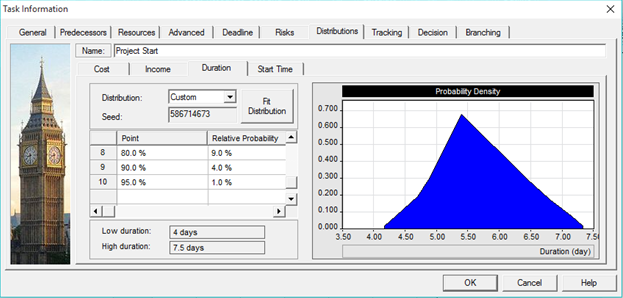

Re: Custom distributions for Monte Carlo
