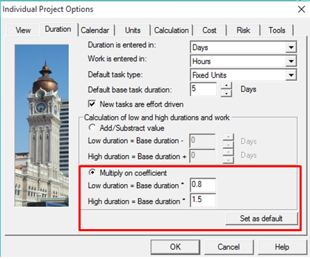

I am still trying to figure out how to set the default optimistic and pessimistic duration values.

If you would like to automatically add low and high default estimates, you can do this in the Project Options Duration tab. In the Calculation of low and high durations and work. There are two different options, to calculate the estimates based on the relative duration of tasks, select the "Multiply on coefficient" option.
A good starting point is to enter a small variance such as .95 and 1.15 to model schedule quality. You can then run a first simulation. At which point, you can review with Project team and stakeholders, to modify tasks that are critical or near critical.
