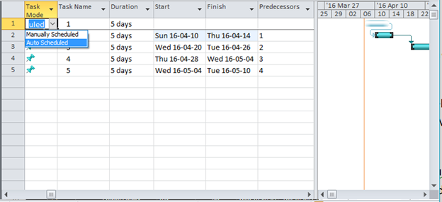

The second case is when activities are manually scheduled. Manually scheduling allows you to drag activities either start date, finish date and durations regardless of the precedent relationships.. This is a very useful feature, but it relaxes the logic that allows the schedule to be updated manually. What that means is that if you have an activity with a FS link to a successor and you move the Finish Date back, this will not automatically update the successor. In practice, it fixes the activity parameters unless you update them manually in that they will not be pulled or pushed by predecessors. When you import the manually scheduled activities into RiskyProject, it interprets these activities as having hard “Must start on” constraints because they are unaffected by any changes to predecessors.
To fix this, once you have settled on your project schedule, set all of the activities Task Mode to Auto Scheduled.
