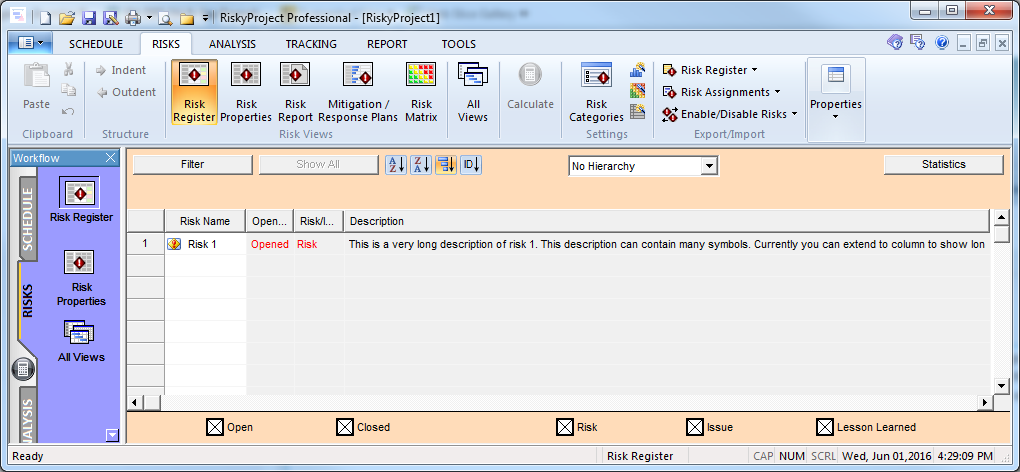

I have long description of the risk which does fit on one row in risk register. Can I use multiple lines in the row for display and printing.

Current version of RiskyProject only allows you to enter one line of text. However in next versions of RiskyProject risk register will support multiple line of any text, for example risk description. Currently you can extend to column to show longer text. To do it just drag the column's header. Please note that when you print risk register report column sizes you defined in risk register view will be maintained. For example if you extend risk description column in risk register view, this column will be longer in the printed report as well.
