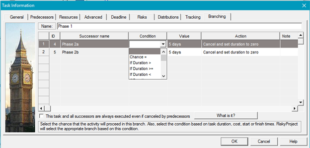

I have set up a couple of branches that I would like to delete from my schedule, but I can’t find a way to remove them.

To remove a branch, double click on the task ID to open the Task Information and then click the Branching tab. Branching tab includes all information about probabilistic and conditional branching. From the Condition drop-down list corresponding to the successor branch condition you would like to remove and scroll to the top of the list. Select the blank space at the top of the list and then click OK. The branch will be removed. It does not matter if this branch was related to probabilistic or conditional branching.
