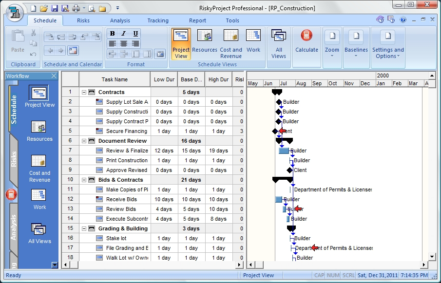

1. Create project schedule.
The original (baseline) project has 93 tasks. They represent all the activities starting from the awarding of the contract and finishing with the final walk-through. Some tasks have the constraint "Must start on".
Other tasks, for example "Review Bids", have deadlines.

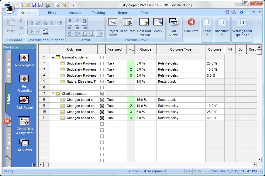

2. Assign risks and uncertainties
Global risks (seen in the Global Risk View) are created based on a generic risk template. These risks are applied to all tasks or resources. They include potential natural disasters, budgetary problems, and potential changes based on client requests.
Local risks are assigned to the specific tasks or resources. For example the task "Secure financing" has the risk "Delay with financing". The resource "Concrete subcontractor" has the risk "Low qualification of the subcontractor". This risk will cause a delay for the task(s) that this subcontractor is involved in.
