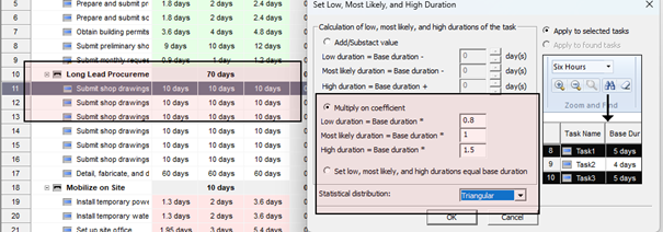

How can I verify that uncertainty values have been applied to a task?

To confirm if the uncertainty values have been applied, first apply the uncertaintioes using the dialog.
1. Select the task
2. Open the Set Low/High Duration dialog
3. Enter coefficients and choose a distribution
4. Click OK.
The updated Low and High durations will then appear in the task fields.
