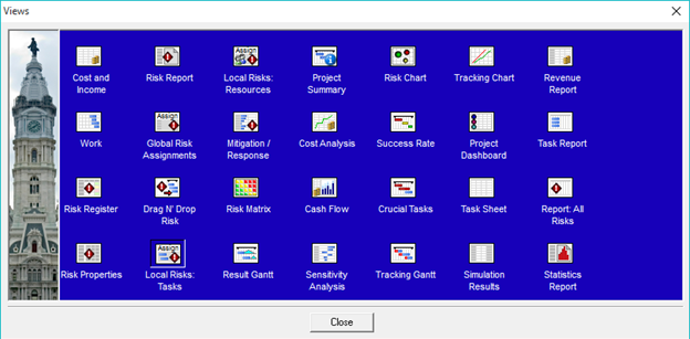

In version 6.1 you may noticed the new Drag and drop risk, but the Local risk view provides a nice overview of how risks are assigned to the tasks without having to go to the Task Information dialog or one of the reporting views. It allows us to look at assumptions for particular activities and quickly modifly risks.
In RiskyProject version 6.1 the Local risks views are still available, but have been moved out of the main ribbon and workflow due to space requirements. You can open the local Risk views suing the All Views button located on the ribbon and workflow bar. Click on the Local Risk view you want to open.
