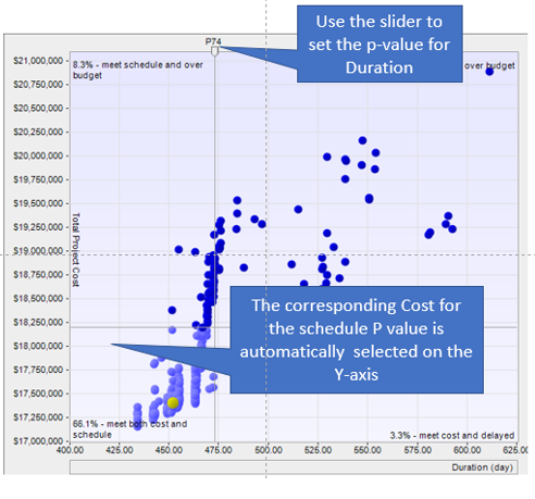

Is there a way to independently set cost and duration percentiles in the cost vs duration scatter plot (e.g. set cost at 90% and duration at 75%)? It appears both percentiles must be the same when selecting the percentiles line in the chart?

The Cost vs Duration Scatter Plot uses a slider to set the P-value for schedule (Cost or Finish Times) and the resulting chance of meeting Cost and Schedule at the selected percentile.
