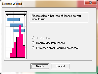

When you install RiskyProject server database you need to go Tools->Update RiskyProject License. The License Wizard dialog will come up. There are three possible configurations of RiskyProject: Trial License, Regular Desktop license, and Enterprise client. You current configuration will be grayed out. You select different configuration: in your case it will be Enterprise client. After this you need to close RiskyProject Professional. When you start RiskyProject again you need to configure connection to the database as it is described in RiskyProject Administrator’s guide. After you configure connection between RiskyProject Professional and server database you may perform Monte Carlo Schedule and Cost risk analysis for all particular projects within a portfolio. Risks and results of Monte Carlo simulations will be saved in the database and shared between different users on your organization.
