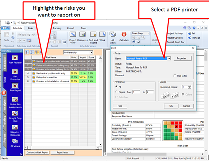

Can I generate report for group of risks as PDF for RiskyProject Enterprise?

Yes you can if you have a PDF print driver available on your network.
First calculate your project. Then go to the Risks -> Risk Report. Select the risks you want to report on by highlighting them in the list of risks shown on the left pane of the view. From the File menu, click Print. From the Print menu select the PDF printer. Here you can also select particular page you want to print.
