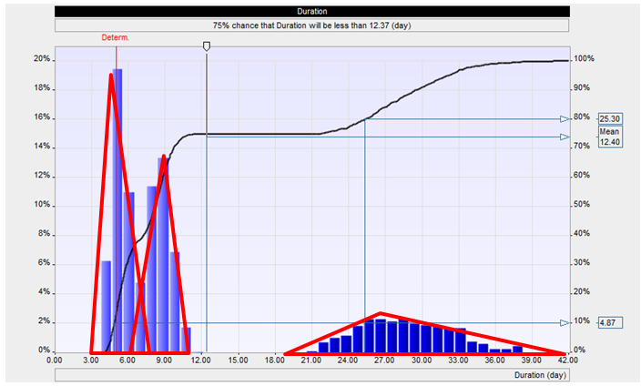

We now have what is called a bi-modal histogram that has two spikes caused by 2 uncorrelated sources of risk impacting the results.

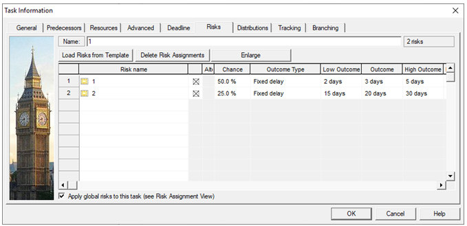

To further develop this, we can add another risk assignment that is not correlated with the first risk assignment.

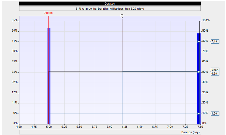

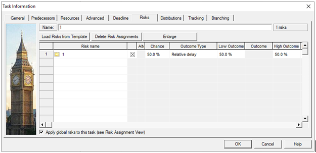

Now, we add 1 risk assignment: 50% chance, 50% relative delay.
In this the original task is the bar on the left and the risk assignment generates the bar on the right.

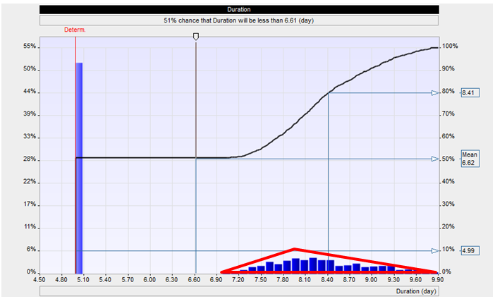

Now if we modify the risk assignment to include an outcome with a triangular distribution with 2,3, and 5 days outcome with a triangular distribution, we get the following output. We can see the risk is appearing as a small triangular distribution to the right of the deterministic bar.

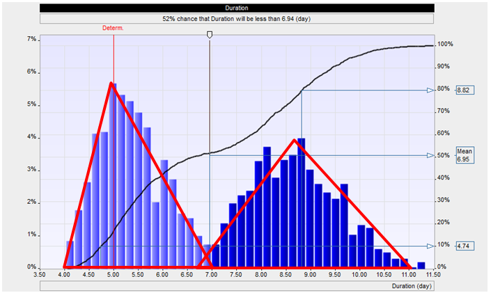

When we add uncertainty to the activity (low of 4 and high of 7, triangular distribution), we get the following output.

When we add uncertainty or aleatory risk to the activity (low of 4 and high of 7, triangular distribution), we get the following output.
