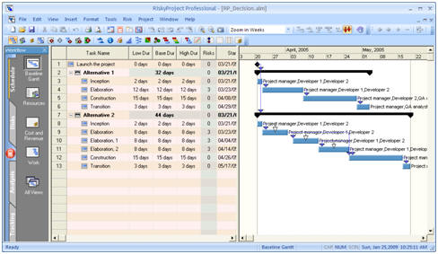

The best way to explain how the integration between RiskyProject and Vanguard works and how you create a decision tree is by analyzing an example. The sample that will be used in this example (RP_Decision.alm) is available in the RiskyProject sample files.
This example represents a high-level schedule for a software development project. The schedule includes two alternatives. Both alternatives include four different phases of the project: inception, elaboration, construction, and transition. The difference between first and second alternatives is that in the second alternative, the elaboration phase includes three iterations. The duration of each iteration phase is 8 days; therefore, the duration of entire elaboration phase is 24 days total. The duration of the elaboration phase in the first alternative is 12 days. Each task has assigned resources. Variable costs for the task are calculated based on the rate of each resource. Fixed costs are not used for this example.
The purpose of a decision tree analysis is to determine which alternative should to be taken based on minimum cost or minimum duration. Cost is calculated as a sum of variable and fixed cost of all tasks for the alternative. Duration is calculated as a sum for duration of all tasks for the alternative._

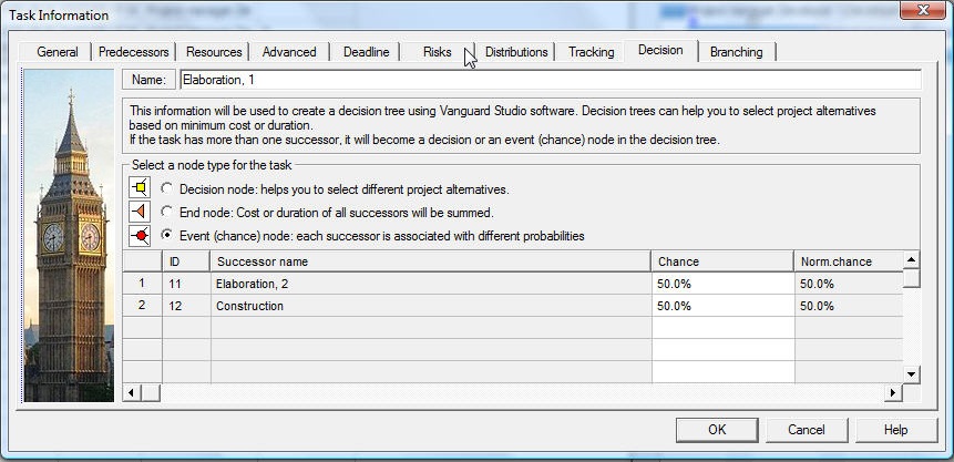

  1. Double-click on the task ID of the task that you want to add a decision node.
  2. Click the Decision tab.
  3. Select the decision node type (Decision, Event, or End) option.
  4. If you selected the Event (chance) node option, you must enter the chance associated with each successor in the Chance column. The Chances values do not necessarily need to add up to 100% as RiskyProject will calculate a normalized chance, which will be used in the decision tree. You cannot assign an event node to the task, where at least one successor is a summary task.

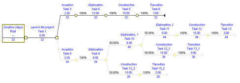

The decision tree above shows that Alternative 1 has the lowest duration of 32 days and is a candidate for the project plan. An analysis of the same project, but using cost as the value measure can be implemented in a similar way, but the export to Decision Pro should be done separately.

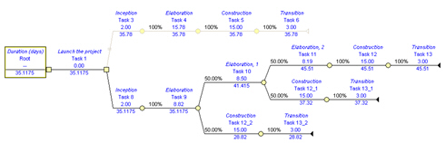

  3. Perform another Monte Carlo simulations on the project and generate a new decision tree:
This decision tree shows that alternative two (with elaboration iterations) will be more effective in terms of duration. Therefore, you can see that if we apply risks to the project schedule different alternatives can be selected.
