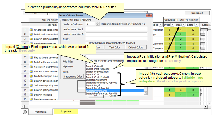

You can define risk properties as columns in Risk Register view. To do it, click on the header in Risk Register and insert column with risk property Defining risk chances and outcomes in the Risk Register gridBy default, the Risk Register’s columns don’t allow you to enter risk chance and outcome directly. You need to define appropriate columns first:
Columns for Chance (Probability) and Score are defined the same way. After you define appropriate columns, they can then be used to enter the risk chance and outcome for each category. See also |
