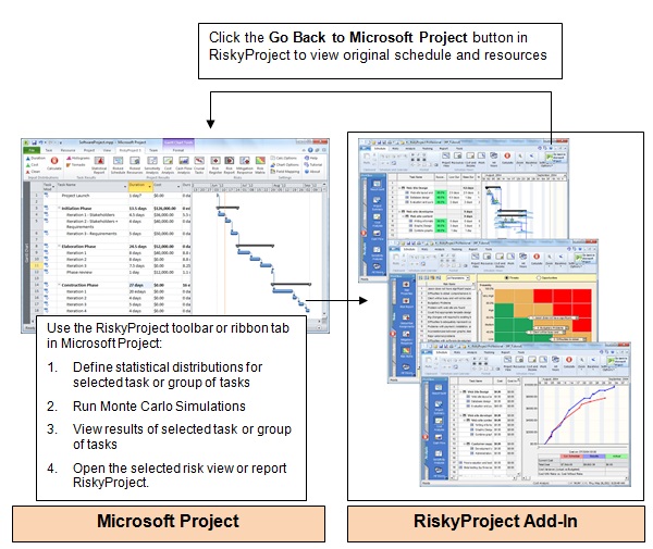

Here is how the integration with Microsoft Project works:
1. The first time you open Microsoft Project after installing
RiskyProject for Project, check to see that the RiskyProject toolbar
is visible. You can enable or disable the toolbar by clicking on
Toolbars in the View menu.
2. Create a schedule in Microsoft Project.
3. Click
one of buttons on the RiskyProject toolbar in Microsoft Project to go
to selected RiskyProject view. Essentially, RiskyProject offers
additional risk related views to Microsoft Project such as risk
adjusted Gantt Charts, Risk Matrixes, a risk adjusted cash flow charts
and others.
4. Add risks, uncertainties, and other risk-related information in the
RiskyProject views.
5. Run the simulation, perform the analysis and report the results
from RiskyProject.
6. At any moment you can go back to Microsoft Project and make changes
to your schedule. All changes will be reflected in RiskyProject.
However if you make changes to the deterministic project schedule in
RiskyProject, these changes may be overwritten by Microsoft Project
schedule.
