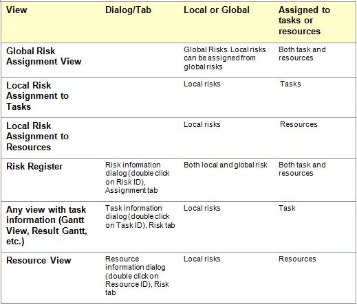

You can edit or view risk assignments in the following dialog boxes
and views:

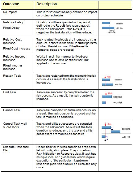

• Each risk has a different outcome. Outcomes can be schedule and
cost related and non-schedule related, which you can customize using
Risk Outcome dialog (Risk menu). Standard schedule-related risk
outcomes are shown in the table.
