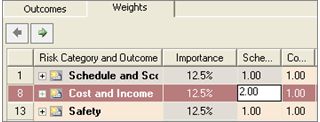

2. Perform a pair-wise comparison to establish consistent ranking or priorities for each risk categories.
For example, after determining your organizations risk preferences, you determine that Cost risk is twice as important as Schedule; you would enter in a 2 in the cell where the Cost category row intersects the Schedule column.
The resulting weighting is Cost and Income 2.0 and Schedule 0.5. Notice that the relative importance of the Risk Category has increased to 13.8 while the rest of the categories have decreased:
3. These weights will be used in calculation of risk impact on all categories.
