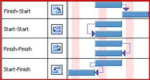

All projects require that the WBS tasks be performed in a certain
order. These relationships are defined in RiskyProject using the
four linking buttons located on the standard toolbar.
The four types of task dependencies are show in the following
figure:
If you want next task to be predecessor of previous task, for
example task 5 to be a predecessor of task 3, you will have to use
Predecessors tab in Task Information dialog box . You should also
use Predecessors tab if you want to define lag time greater than
zero.
