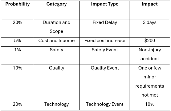

When assigning risks to tasks and resources, it is essential to select the type of risk impact. For example, this table illustrates how risk assignments that include non-schedule impacts might appear. Each category of risk has its own impact type and numerical scale, allowing for a more precise quantification of the risk impact.
For instance, a 20% probability of a fixed delay in duration and scope might result in a 3-day delay. Similarly, a 5% probability of a fixed cost increase could lead to an additional $200 in costs. By assigning numerical values to these impacts, project managers can better understand the potential consequences of each risk.

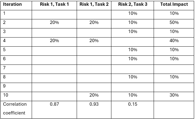

To perform a quantitative risk analysis, project managers can use tools like Monte Carlo simulations. These simulations help quantify the impact of each risk category and rank them accordingly. For example, this table shows the results of Monte Carlo simulations for the safety risk category. By calculating the correlation between risk impact and the total impact for all risks within the same category, project managers can determine which risks have the highest impact.

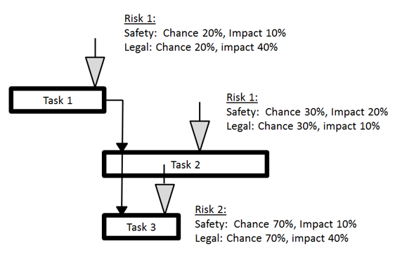

Here is a sample schedule. In this example, we assigned the same risk to two different tasks, and second risk to the third task. We use numerical scales for risk impact; however, it can be assigned using a label which represents an underlying value. Our goal is to rank the risk using quantitative analysis for a single risk category and the for all the risk categories.
