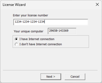

A. If you have an Internet connection when you validate the license, enter your license number (e.g. 1234-1234-1234-1234) and select “I have Internet connection” and click NEXT >.
License Validation: With Internet Connection

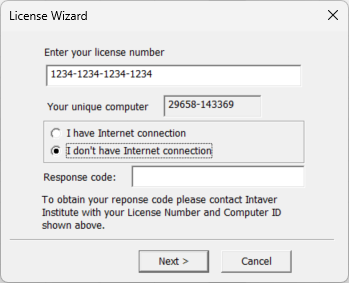

B. If you do not have Internet connection when you validate your license, do the following:
  • Record the unique computer ID from the License Dialog, as you will need it for the next steps
  • Get your response code based on your license and unique computer ID
  • Go back to License Dialog, select “I do not have Internet connection”, enter your response code, and click NEXT >.
Please note that you can use this Response Code only for perpetual license of RiskyProject.
License Validation: Without Internet Connection
