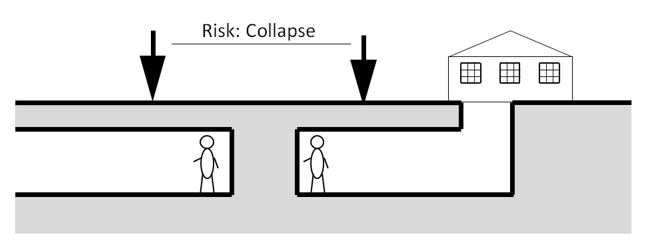

What happens if the risk is assigned to multiple tasks? How to prioritize risks in this case? Here is an example. A Mexican drug lord El Stuppo wants to escape from jail. To do so, he is digging a tunnel from his side, and his associate is digging a tunnel from the opposite side. They are hoping to meet somewhere in the middle. But there is a risk that the tunnel may collapse. So, there is a single risk, but we have to assign it to different tasks: “El Stuppo digging” and “Associate digging” with probabilities of 30% and 40% respectively. What would be the total probability of this risk?

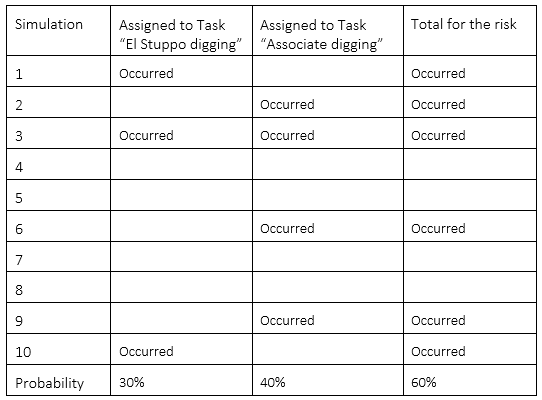

Everything depends on how these assignments are correlated. Let’s assume that the collapse is caused by heavy rain, which can occur at the same time on both sides of the tunnel. In this case, the risk assignments are correlated, and probabilities are equal to maximum probability of both assignments: 40%. If risk assignments are not correlated, then probability is calculated as is shown in the table below.
