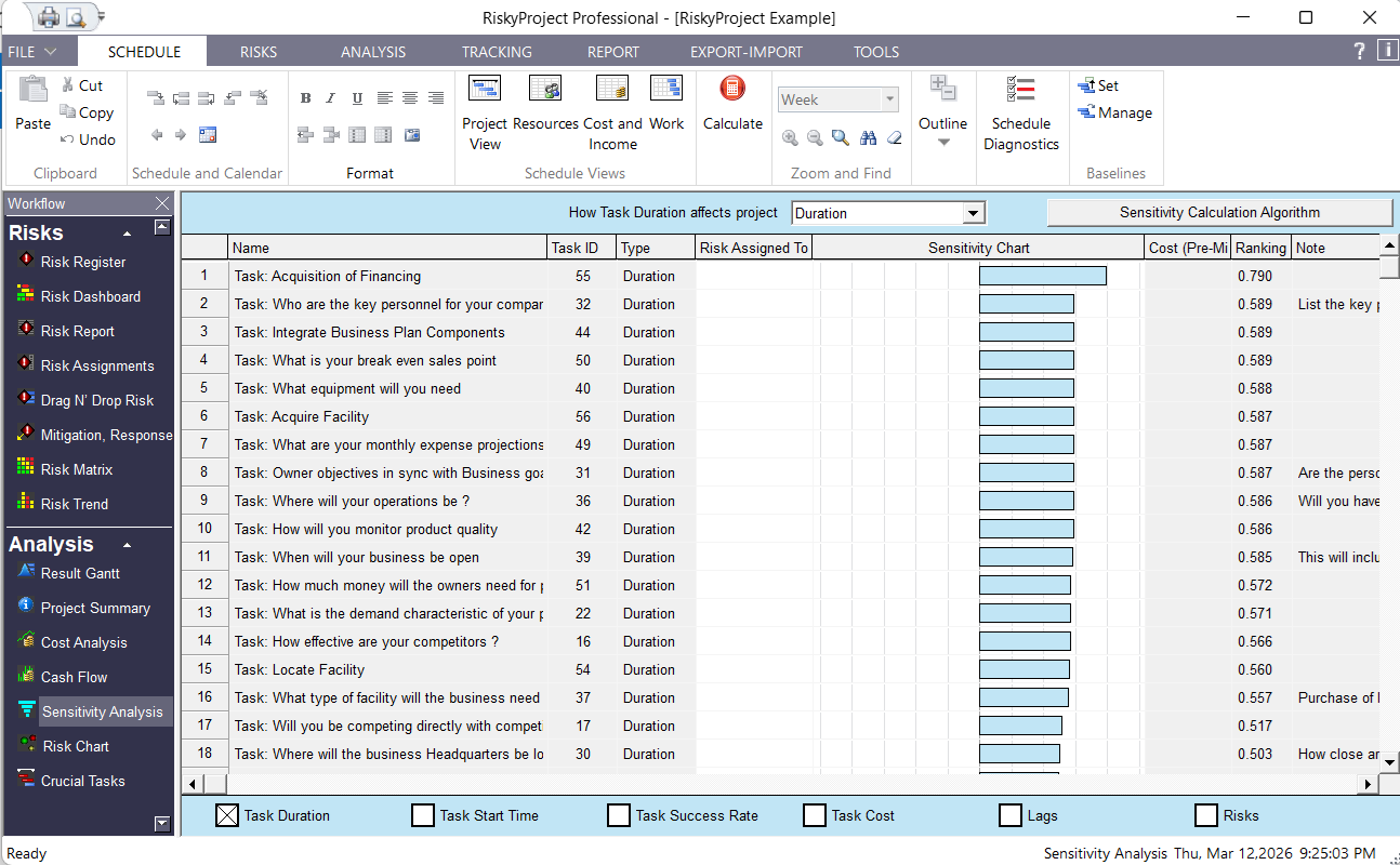

Sensitivity analysis determines which variables have the most potential to affect your project. These variables are:
- task duration, task start time, success rate and costs
- risks
- lags between predecessors and successors
You can check how these variables affect the main project outcomes:
- total project cost
- project finish time
- project duration
- project success rate
The sensitivity chart displays sensitivities in descending order: variables whose uncertainties affect the project schedule the most will are placed at the top.
