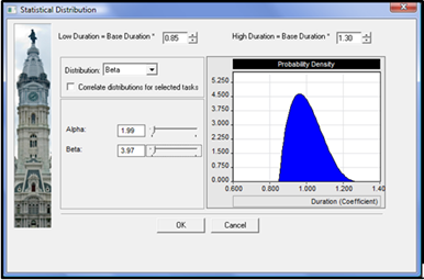

  1. The RiskyProject Addin provides an easy to use dialog box in which you can enter your low and high estimates and statistical distributions for activities or groups of activities. You just need simply select an activity or group of activities and click on Duration or Cost button within a RiskyProject toolbar. Then you would need to define distribution parameters
Add distribution
Figure 3: Add estimates and distributions to your project
