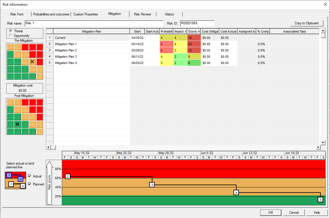

You can define mitigation plans using the Mitigation view. Mitigation plan can be execute when risk is occurred. RiskyProject will count, how many times the mitigation plan is executed. The diagram, which shows how often the mitigation plan is executed, will be displayed within a mitigation view. One mitigation plan will be executed only once per task even multiple risks occur.
You can assign mitigation plans defined in the Mitigation and Response view to your risks. One risk may have multiple sequential mitigation plans. They can be shown as a Waterfall diagram. Waterfall diagrams can be used to visualize the timing of mitigation efforts over the course of the project.
